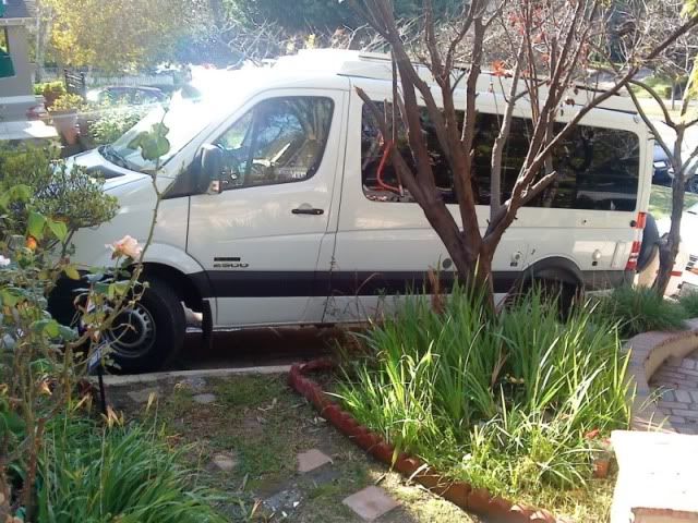

Postby oschreiber » Wed Dec 30, 2009 12:30 am
Conversion comes with External Tire Carrier on a left rear receiver and a center hitch receiver.
Bought MAX Swingaway Plus Cargo Carrier (http://www.stowaway2.com/product.aspx?id=130&cid=59) mounted on center hitch receiver.

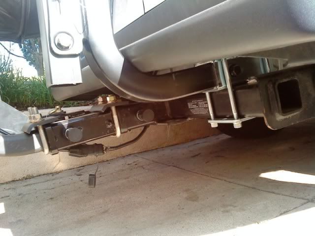

Added third hitch receiver (an RV bumper 4" hitch receiver http://www.prolineracks.com/bumper-hitch-adapters.html) to mount on right side of 2.5" hitch square tube.
Bought a 5 bikes hitch carrier (http://www.discountramps.com/5-bike-carrier.htm) to mount on
Bought a Yakima 6 ski carrier to mount --upside down because of clearance--on bike carrier(http://www.amazon.com/Yakima-HitchSki/dp/B000B0KTEQ)

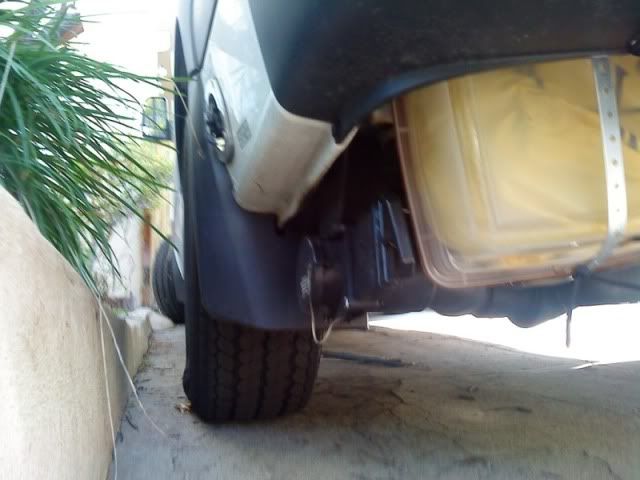

Used right rear space under chassis behind hitch to fit tire chains held in place by screws--no plastic because next to exhaust.
Used left rear space under chassis behind hitch to fit box to carry waste 3" hose next to tank valve.

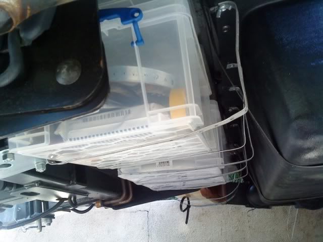

Used center rear space under chassis in front of hitch and behind BW/GW tank to fit 4 10"x14"x6" boxes to store electrical hookup cables, water hookup hoses and tools. (http://www.reallyusefulproducts.co.uk/usa/ bought at Staples/Office Depot)
Spare tire, Swingaway Stoaway2 cargo box, bike and ski carriers
4" RV hitch receiver for bike carrier
Right rear space under chassis behind hitch for tire chains.
Center storage area for 4 boxes
Box for sewer 3" hose storage on left rear behind BW/GW tank drain valve
Box for sewer 3" hose storage on left rear behind BW/GW tank drain valve.
Short chassis with Penthouse pop up top and solar panels.

are the opaque plastic containers heat resistant? I'd be concerned that engine exhaust
or just reflected road heat might cause some melting or warping of the plastic, and/or
a possible fire hazard.
Have you road tested this setup yet?
Great pics of your mods, btw.

In my post, I had mixed up `left' and `right' so the tire chains are close to the exhaust but without any plastic box.
The center boxes are `isolated' from exhaust by the flange of the hitch assembly.
You're right though, road heat could be an issue in the summer. Until then, I should look for 6"x10"x14" metal boxes.
I drove tested the setup and it did not appear to be any noise or motion of the boxes.
You can see the semi-rigid metal strips holding them in place. (they are attached to under body by self-drilling screws).
That is evidently the most critical aspect of the setup so suggestions for improvements are welcome but

I might look for some sort of short "leash" for the boxes, like a safety chain
on a trailer hitch, in case the unthinkable happens and one comes loose. Metal
boxes might solve (or worsen) the heat issue if it happens, but may create
another if you're traveling anywhere where you might be searched. I don't know
how difficult it is to open them for inspection, but you might be asked to at border
crossings, and higher security landmarks, like the Hoover Dam for example.
How are the tire chains secured? I'd hate to run over a set of them at speed. :wtf:

The roof has 4 solar panels covering the whole surface.
One box holds the city fresh water hose and filter.
One box holds the electrical hookup cable.
One box holds tools
Another box is empty right now. I could put the macerator pump and 1" hose perhaps.
They are all 6"x10"x14" to fit just right in that space.
They are not heavy so detaching one of the semi-rigid metal strips is enough to slide them out but I do need to lie down to do it.
I will look for metal boxes--hopefully light ones and the` leash' is a solid idea indeed in case the unthinkable happens as you say.
The chains are the cable type so they are pushing against the walls around them and I have the same metal strips bolted and pushing against them preventing them from falling down.
In CA/AZ/NM/UT, we won't have to use chains too often but if you don't have them, they won't let you go through.

I was thinking that metal boxes could be a bad idea, as they might turn into ovens
in the hotter weather, and roast your stuff. Unless you could find some made of aluminum
which would heat up, but would also cool quickly. The ones I see online are mostly
lockable which might also be a nice feature when you're on the road. Security.
